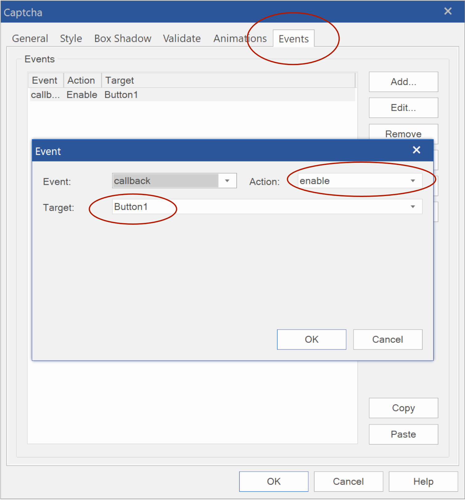

The idea of the callback event is that the submit button is initially disabled (via the properties of the button)
Then use the callback event of recaptcha to enable to the button.

That would be via Submit object > Object Properties > General (tab) - check Disabled field right?
Ok, lost me here - which object am I adding that event to and I can't see that event in any event drop down list please?
OK.....

CorrectThat would be via Submit object > Object Properties > General (tab) - check Disabled field right?
The (Re)captcha object.which object am I adding that event to and I can't see that event in any event drop down list please?

I was referring to the built-in recaptcha.

Toolbox -> Forms -> CAPTCHA -> Type -> Recaptcha

The built-in CAPTCHA object also supports reCAPTCHA v2 and v3!

GOTCHA! I thought that was going to be the case:Pablo wrote: Fri Sep 04, 2020 6:27 am The built-in CAPTCHA object also supports reCAPTCHA v2 and v3!
WB16 > Toolbox > Form Controls > Captcha > Object Properties > General (Tab) > change default to reCAPTCHA v2 or v3 or math or hcaptcha.
OR
WB16 > Insert > Form > Captcha > Object Properties > General (Tab) > change default to reCAPTCHA v2 or v3 or math or hcaptcha.
