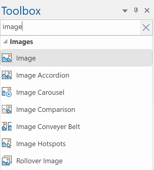

Posts: 3038
Re: Carousel & Layout Grid
What is the name of the extension? When I check my toolbox, I just see carousel and image carousel but I may not have that extension installed.

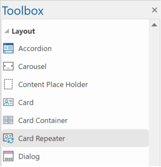

Posts: 5933
This is the two carousel objects in the "Toolbox" that I know of. If you are using an "Extension" can you please name it

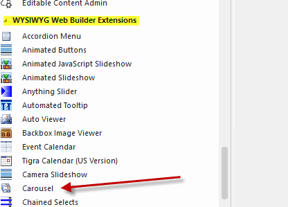

bjlolmaugh
Posts: 162
Joined: Thu Nov 15, 2007 2:36 pm
Post by bjlolmaugh »
I guess there are 3 instances of the Carousel then.
This one is in the Extension section:
Sincerely,
Barbara Lolmaugh
http://www.websitesbybarbara.com
Posts: 3038
I'm not familiar with this one. When you open the properties of that extension, in the bottom left who does it say created it?
Posts: 5933
OK can you please go to your "Extension Manager" and note who the developer of the Extension is. The only one I can find named Carousel was by Eddy who is no longer active and no longer support provided.
Barbara please also note that all of the extensions listed in the screenshot some by myself, Adendum, zinc and one by Pablo are no longer available or not supported or are deprecated
