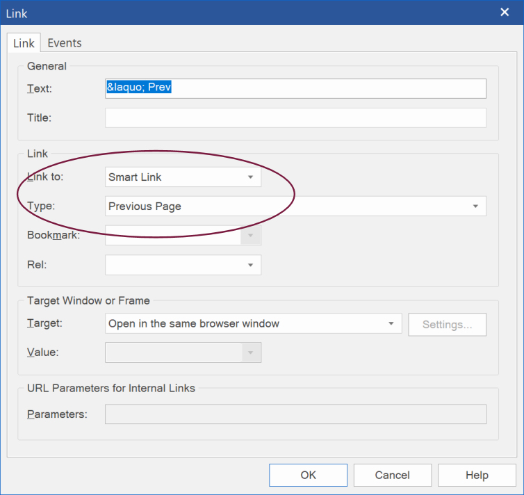

To disable the next or previous button and use the disable colors, use a smart link and set it to 'next page' or 'previous page'.

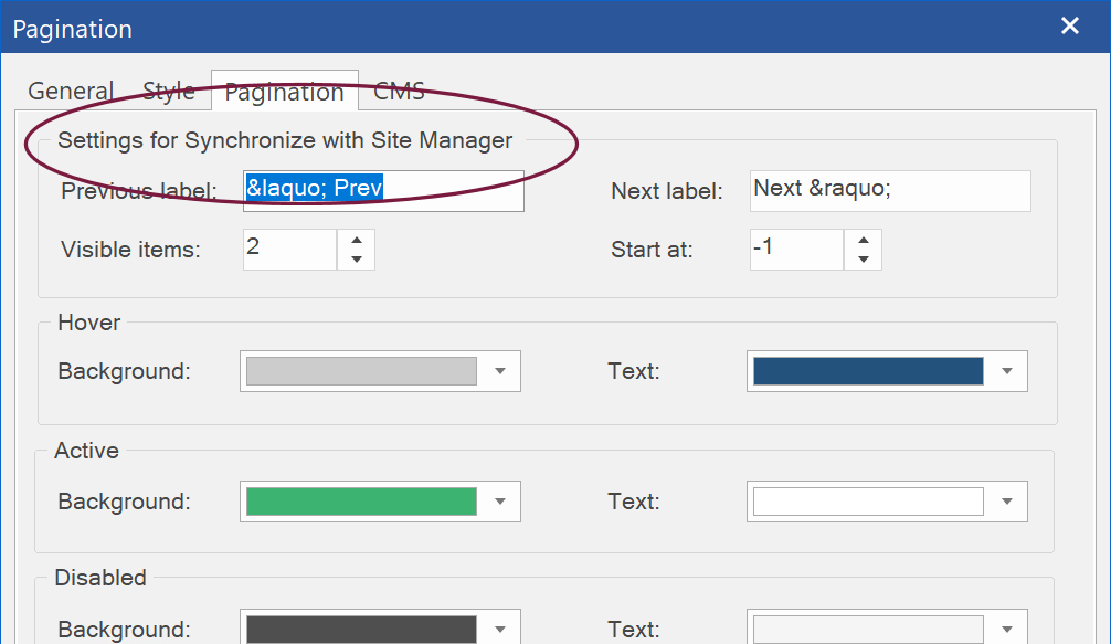

I have set in the properties of the Paginations, Tab Paginations, Visible items 2.
But it shows all pages. If I understamd this correctly, it shouls show only 2 pages (Visible items 2) and then ellipse ("...") between them, showing that there is more pages between them.

You did specify the items manually, so in that case it shows all.

This option is for use in combination with 'Synchronize with the Site Manager.If I understand this correctly, it should show only 2 pages (Visible items 2) and then ellipse ("...") between them, showing that there is more pages between them.
To disable the next or previous button and use the disable colors, use a smart link and set it to 'next page' or 'previous page'.But could never get the actual Collor and a Disable Mouse cursor when scrolling over the Example: NEXT button which should be Disabled to even click on it.
