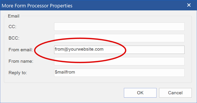

The form script does not have an email filter and also does not suddenly stop working.
If you did not change anything yourself then this is most likely related to the server.
It may help you set a fixed 'from address' in the form's properties.
In some cases, this must be an email address with the same domain as the website.

If any of the other email addresses are from the likes of (free) Yahoo, Hotmail etc then you may experience the same with them after a few weeks also. Host generally don't like the use of "Free" email addresses for the reason they are used to spam so hence why it preferred that a domain email is used. So with said you will will need to use the email address from your host rather than Gmail or any of the other "Free" emails.
