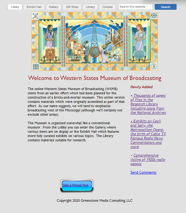

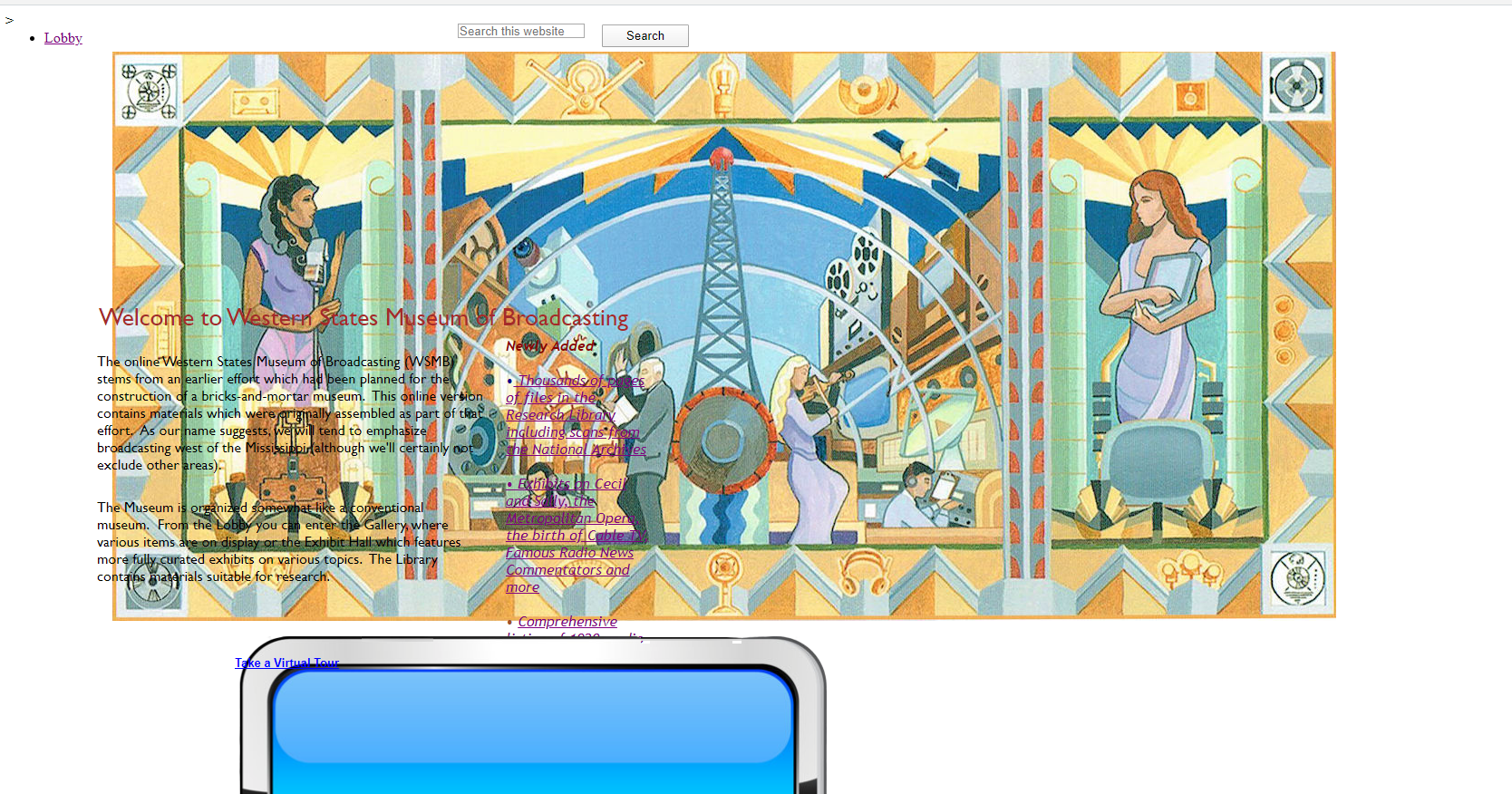

This has been a bit of an ongoing problem for me. When I last asked for help in the Forum helpful responders told me to make sure that I had no spaces in image file names and put underscores in their place. I did that and it partially solved the problem. But here's the way things stand. Occasionally, a page which is newly published (or edited) doesn't display properly in Chrome or Edge. It's as though it looses its formatting. If I do a hard Refresh (Cntrl F5) the page refreshes with proper layout. However, I'm not the only one who experiences this. A friend recently went to my site and when the index page loaded it had a graphic that overran all the rest of the page so the problem isn't just mine. It's kind of like the download isn't properly bringing in the CSS file to get the proper layout and then, if you hit refresh, it does. If I preview a page before publishing it, it ALWAYS looks right. It's only when it downloads from the server that it looses formatting. It seems to me like this has something to do with the way the page gets published by Web Builder -- but I am completely stymied as to what it is doing and why.
Images for the corrupted version and the proper layout are shown here. I'd appreciate any pointers you can give me!
