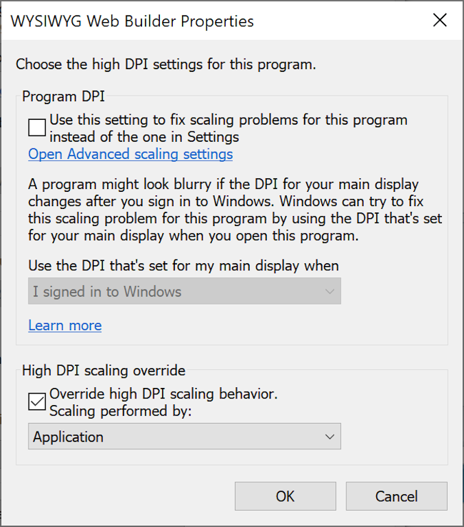

I have tried the options you suggested but still having issues with text and curser. For example, the first paragraph, "Harry K has been in...."
When I place my curser on any letter, the curser does not edit the immediate letter it is on, but will edit one letter behind.
Since the compatibility adjustment you suggested, it has brought the curser closer, before it was 3 letters behind, now only 1 but still not exactly where it should be.
It is interesting to note that this only happens when using the 'text tool' directly on the page.
The 'text area' and 'text art' etc (which are editited inside boxes), are totally uneffected and function exactly as they should....only on the actual page is the problem.

Posts: 23687
Re: Text Allignment way off
I'm sorry, but I cannot reproduce this problem with your project (or any other project).
However, it is important to understand that the text editor is standard Windows functionality.
Maybe it is related to the font you are using?
Do you have another computer you can try it on, so we can be sure this is not an issue of your computer?
Note that I am not referring to 'compatibility' or Direct2D. I am referring to the DPI configuration of your computer and/or the application's DPI.
Windows has several options to control how the text is scaled (which also affects the cursor). Did you try them all?

Pablo wrote: Tue Aug 10, 2021 9:04 am I'm sorry, but I cannot reproduce this problem with your project (or any other project).
Yes, I have tried all your suggestions, including the 'override' to no effect. I don't have any other computer as I have only just upgarded my system and got rid of the old one. However this is the only program with this issue, and the issue is only on the main page using the text tool.Very wierd.
