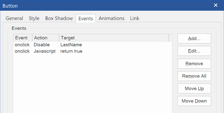

- Posts: 24976
Re: Reset disable field in the form
You will need to add the following events to the reset button:
