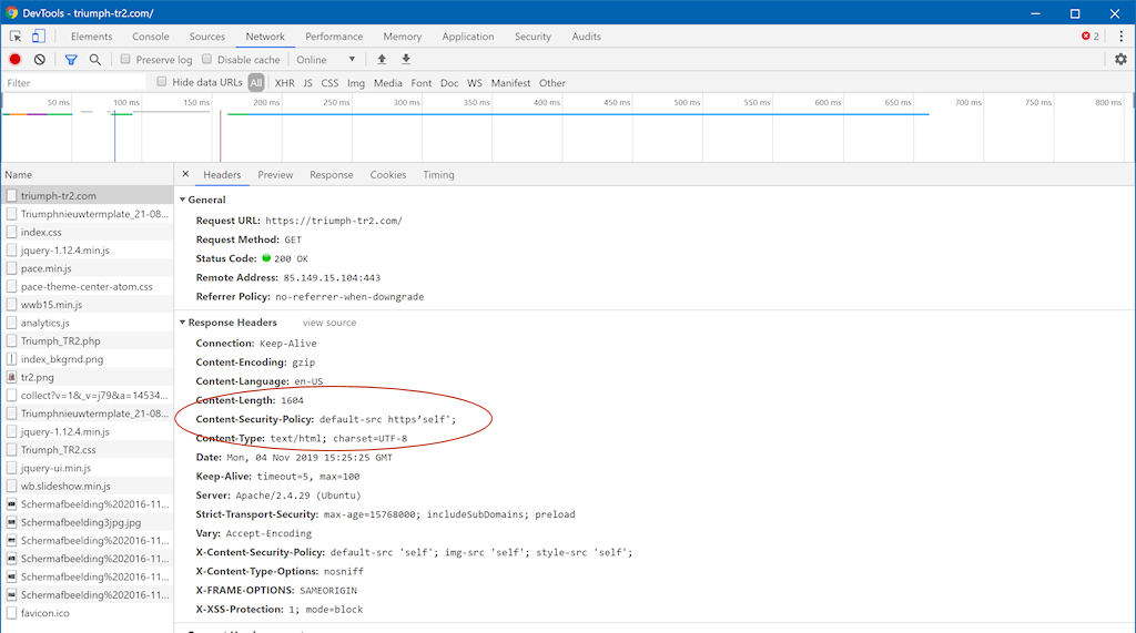

I think this is a configuration error on the server side.
The reason why the page does not load is:
It looks like this is added somewhere on the server:
https://developer.mozilla.org/en-US/docs/Web/HTTP/CSP
(you can view this in the browser's console)The value for Content Security Policy directive 'default-src' contains an invalid character: 'httpsâself''. Non-whitespace characters outside ASCII 0x21-0x7E must be percent-encoded, as described in RFC 3986, section 2.1: http://tools.ietf.org/html/rfc3986#section-2.1.

The problem was the .htaccess Content Security Policy. I rewrite the CSP it and now Firefox works again.
Thanks a lot
