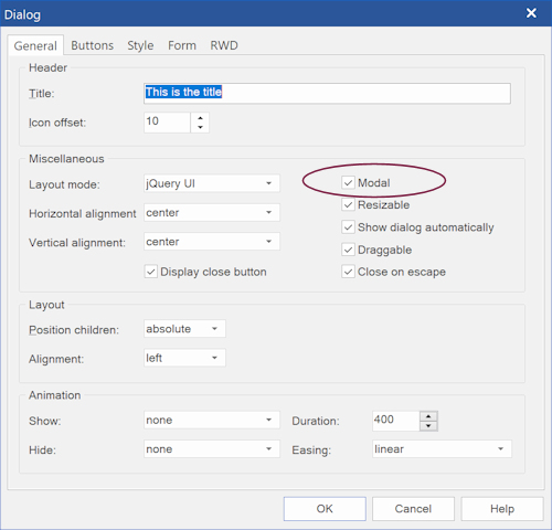

The dialog can be made modal via the 'Modal' property , this will ring it in front of all other elements on the page.
WWB will set the z-index to 9999 automatically via
If the payment gateway does not work inside an inline frame then I think the only option is to break out of the frame (via target->_parent)

- Posts: 24981
Re: Making a popup MODAL
You do not have to insert this code yourself. It will be added by WWB when you enable 'modal' property of the dialog.

- Posts: 24981
'Modal' is a property of the 'Dialog' object.
- alex4orly
- Posts: 632
- Joined: Mon Jan 20, 2014 8:17 am
- Location: Australia
Ok, where do i set it?
I can't find it anywhere
I see, you were talking about the Dialog object itself, I was talking about the html page to be Modal.
So, now that works - just the Membership button
