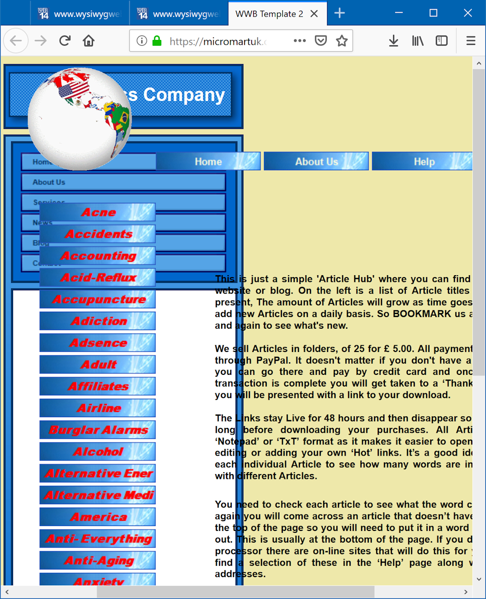

Because I was finding version 14 a bit daunting I started building a website with one of the templates that come with the software. As I'm selling website articles I have rather a lot of niches to list down one side and I'm running out of space. If I just keep going the page will be the longest in Internet history.
Is it possible to add scrolling to one of these templates so I can keep adding niches and visitors can just scroll down the page to see buttons that are out of site?

Do you have a link to the page so we can see what you are seeing?

The scrollbar seems to work correctly.
However, you did not adjust the layout of the breakpoint, so most content is outside the viewport.

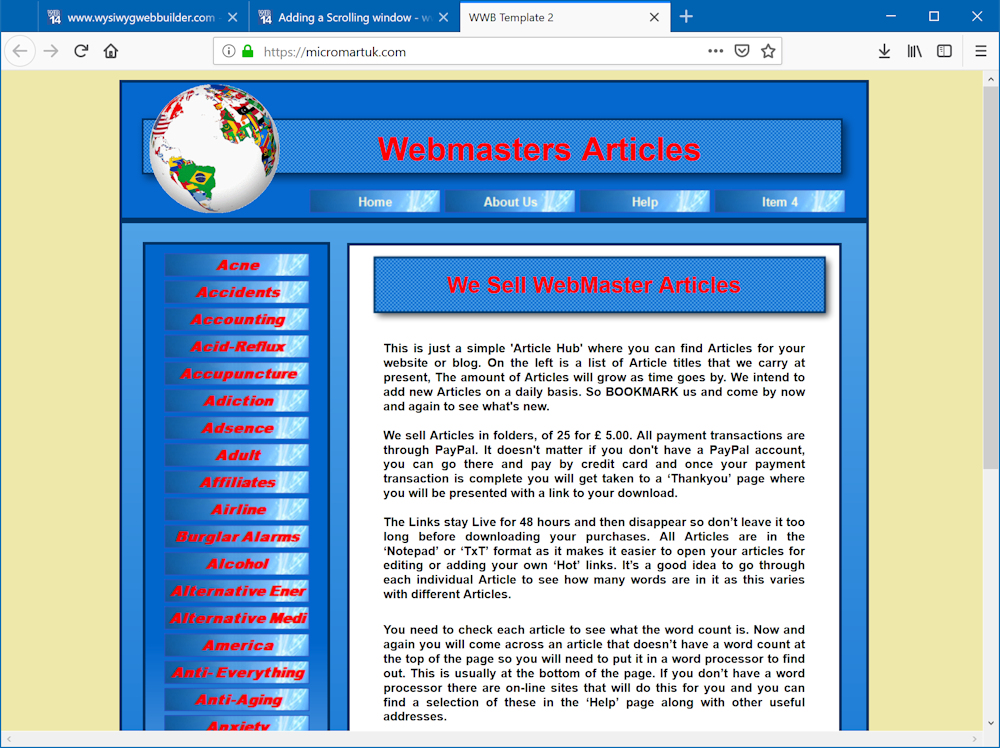

This is what I see (there is a scrollbar at the right side):
I cannot see exactly what you have done based on the HTML only, so I'm just guessing. But it looks like you have added a breakpoint.
You will have to switch to the breakpoint(s) and make sure everything fits inside the viewport.

Are you referring to where the menu extends beyond the bottom of the page as below?

Yes I was
I wanted a scroll bar down the right-hand side of the contents window so I could add many more niches to the list, but for some reason, a scroll bar isn't forthcoming.
Pablo says its something to do with adding a 'Breakpoint', but I didn't add any as I didn't know what a 'Breakpoint' was at the time. I have found out that 'Breakpoints' are added to a template to make it compatible with different screen sizes when viewed on a tablet or mobile phone. They make the screen bigger or smaller (Responsive) depending on what you're using to view the website with.
I don't see the connection between 'Breakpoints' and the scroll bar not being there. What I was thinking was that the Template I used was just a standard guide for people to get an idea of how a website will look once you build the real thing using the software and not an actual template that someone had made for their own website, a fully working one.

Menus normally do not have a scrollbar, that might be confusing for the user.
But if you really want this then you can place the object on a layer and set overflow to scroll (not recommended).

You can also place the menu inside an inline frame, but some mobile browsers may not like that.So this is the only way I'll be able to have a scroll bar on that window.
By 'not recommended' I meant that a menu with a scrollbar might be confusing for the user.What did you mean by (Not Recomended) will it break if I do it or what.......
If you have a lot of menu options then maybe it's better to consider another menu?
https://www.wysiwygwebbuilder.com/navigation.html
