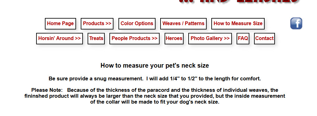

OK. Let's put the old code aside.
Here's another example.
First picture is how it look on my desktop PC Chrome Browser & my mobile phone browser (This is how it's supposed to look):
Second picture is how it looks when I click on a link from my FB page (the text is overlapping). This is what FB is doing to the page.
There is no custom code on this page. It is straight WWB code.
My question is why does the page look differently on the FB browser (which I hate) and every other browser on a desktop or mobile device?
Here's a link to the webpage: https://www.paracordpetcollars.com/sizing.html
Sincerely,
Barbara Lolmaugh
http://www.websitesbybarbara.com

The overlapped is caused by the invalid configuration of the text.
Please set the text output format to anything but 'use div ... do not use for rwd)'.
See also:
viewtopic.php?t=34318

Post by bjlolmaugh »
I did that "fix"... didn't change anything.
Please keep in mind ... this is ONLY appearing on Facebook's browser.
I use FB to market my product. When people click on the link in the FB post, the website opens up in FB's browser, not a third party browser.
This is still how it looks on FB's browser.

Posts: 23776
Re: Facebook Browser
It looks like the option 'use div' is still selected.
Please make sure NONE of these two deprecated options is selected.
Also republish all files after making the changes.

Pablo wrote: Tue Mar 18, 2025 3:39 pm It looks like the option 'use div' is still selected.
What's frustrating about this request (not frustrated at you) was back with Ver 11, changing all my text properties to use the DIV code was how to resolve a lot of the text formatting issues. So every single one of my websites, on every single text box, has that property set. It's going to take me a VERY long time to change it all back. Issues like this is one of the reasons why I never wanted to upgrade to a newer version.
Thank you, by the way. That resolved the text overlap issue in the FB browser.
Now ... on to figure out how to resolve the rest of the issues.
