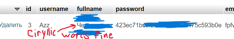

Good morning Pablo.
The whole paradox of the situation is that when you correct the data through the Administrator form or add new ones, everything works very well, and only when you need to send the user registration form to the user, the Cyrillic alphabet is not perceived for some reason.
Everything you answer to me is good and true, but it does not solve the problem.
In my opinion, when a request to change data is made from the administrator's form, it is connected to the database and only then everything works on a working connection.
When the user registration form is filled out, it is not yet connected to the database and the connection starts after clicking the button. At this moment, the database does not understand the coding sent to it and refuses to accept it. For what specific reason, I may be wrong, but it is most likely a different reading of the mysql and html code, as you correctly wrote that they are different.
Do the experiment yourself and make sure that the problem exists. It won't take much time. only experiment on real hosting, and not on a server on the same computer.

I explain what is not working.
When the user name and full name fields are filled in the user registration form, this information is not saved in the table, and when these fields are filled in Latin, everything is saved.
I use google translate, so you may not understand my problem. I'm sorry this annoys you.

The object is the user registration form and the Full name field in it.
I remind you that it does not allow the user to enter Cyrillic data in the Full name field.
I will be very grateful if you can provide me with step-by-step instructions on how to make it possible for the user to fill in the Cyrillic Full name field in the registration form

Hola, feliz año nuevo, Pablo!
Llei la documentacion, pero sigo sin poder resolver mi pequeño problema con el USERS_LOG.
Todo me funciona perfectamente, con el (utf8_ unicode_ci) al registrar un usuario nuevo, i las demas funciones de Login Tools menos el Users Log.
Pues se trata de que simplemente no hace nada. No añade ninguna informacion al USERS_LOG (En mi caso es USERSLOG sin la barra vaja_)
Pero todo lo demas funciona correctamente, USERS, CMS_, etc. Ya lo comprobe.
Aqui añado las fotos donde se puede ver que "cyrillic" funciona en USERS, se añaden usuarios nuevos, pero USERSLOG sigue vacio, por esta razon creo que no tiene nada que ver con el UTF8_UNICODE_CI :
Tambien por si a caso lo converti en FORM para ver el HTML, quizas asi se podra localizar la razon de todo esto:

Que se puede hacer para que USERSLOG funcione?
Muchas gracias!

Azz
Posts: 8
Joined: Sat Jan 04, 2025 1:17 am
Re: Login tool USERS LOG
Post by Azz »
Hello, finally I solved this problem, just changing localhost program, for other. Now MySQL logging users works perfect! Thank you for attention :)
