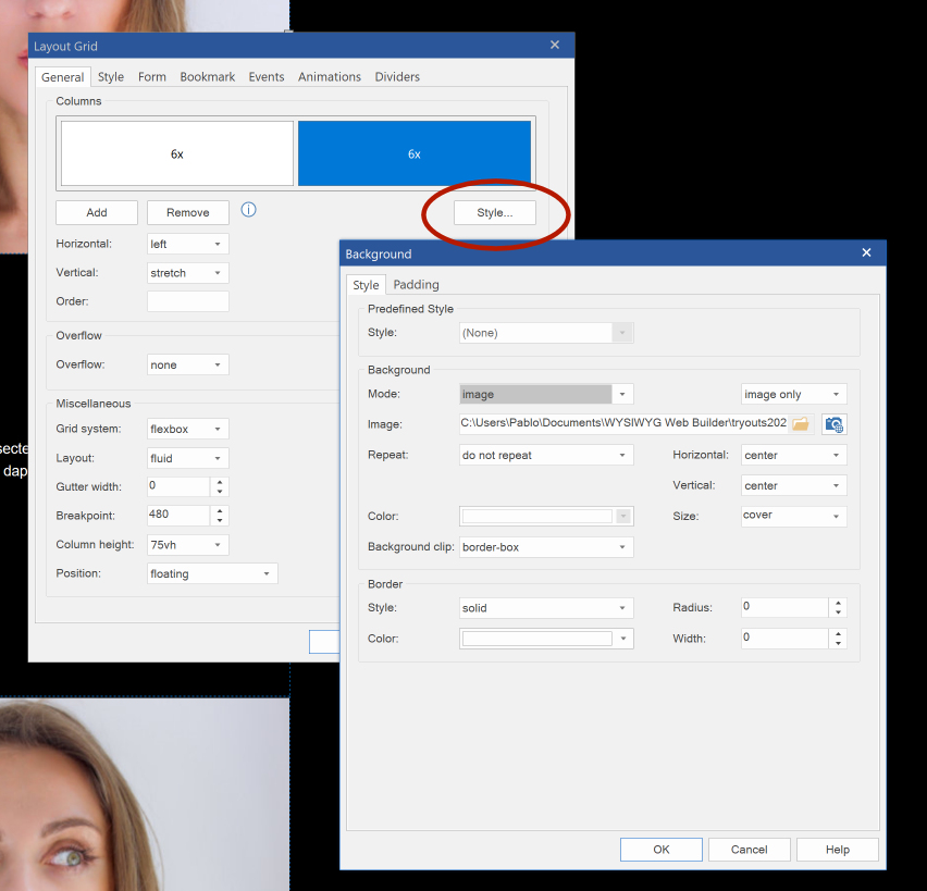

I downloaded expertise.wtp from the wysiwygwebbuilder templates. Could someone tell me how to change the photos on the first page?
I can do it in any other templates, but NOT in this one: "expertise.wtp"
How to change photos in expertise.wtp ?

It is NOT in this template... I do right click-properties (or double click) and have Layout Grid properties, no way to change photo.

I want to change photos in this template: https://www.wysiwygwebbuilder.com/suppo ... ayers.html
I can change photos in wb16_expertise_layers but NOT in the first page: wb16_expertise

These are background images.
You can change them via the Style properties of the layers or column properties of the layout grid.

It is true in wb16_expertise_layers page, but NO in the first page: wb16_expertise
If I open the properties of the object on the first page, and then select Styles, the photo is not there.

You will need to edit the properties of the grid column. Not the grid itself.

THANK YOU!!!! Now I can do it!
