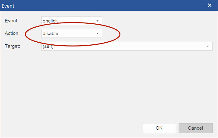

1. Add an 'onclick' event
2. Set action to 'disable'
3. Set target to 'self'

Pablo, I am using the BUTTON from the form controls toolbox. In the event for button, i can't see the "disable" in the action list. Do I not use the BUTTON and instead use something else?

'disable' should be in the list (WWB17)

I have version 15 and I can see the action "disable". However, I did exactly what you said, but now the form doesn't seem to work.
