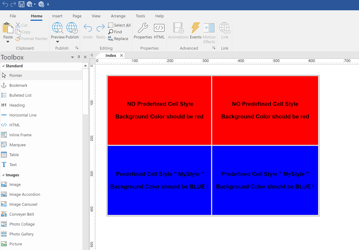

The sample project
http://www.filedropper.com/cellpropertytest2_1
WWB 16 WORKSPACE (!!) is showing:
The upper cells do NOT USE a Predefined Cell Style, therefore the background color should be red
The lower cells DO USE the Predefined Cell Style "MyStyle" , therefore the background color should be BLUE !!
Result in WWB16 workspace (NOT the generated page in the browser):
The lower table cell backgrounds should be BLUE (!!), but in WWB16 workspace the cell background color is RED !!

Posts: 25002
Re: [WWB 16] Predefined Styles in Cells Properies
I'm sorry, but it works for me.
For me the background color is rendered in the background of the workspace.
I think it is related to your settings.
BTW: " Direct2d text rendering " is a setting in firefox and has NO EFFECT how WWB 16 workspace is showing tables.
This option has nothing to do wit FireFox. It controls how text and tables are rendered in the workspace.
Note that you do not have to SHOUT at me. I have the best intentions to help you. However, if I cannot reproduce the problem then it's difficult to 'fix' it.
This is what it looks like for me:

Posts: 25002
Unfortunately Windows 7 does not support Direct2d text rendering. That is why the option is disabled. Also, this is most likely the reason why the background is not rendered in tables.
I am sure that if you try it on a Windows 10 computer that it will work.
Microsoft made a lot of improvements in Windows 10 related to text/table rendering.

Posts: 25002
This topic is related to Direct2D is general, used for rendering the workspace like images and shapes.
On top of that is "DirectWrite" which is used for (rich) text rendering. Windows 7 does not support rendering rich text via DirectWrite. In that case, WWB falls back to GDI.
