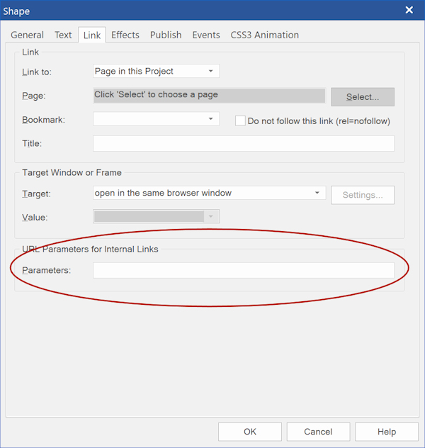

Posts: 24944
Re: Adding campaign parameters (UTM Tracking Code) in WB
For external links you can just include the parameters in the URL.
For internal links you can use the 'Parameters' option in the link dialog:

Posts: 24944
The '? should not be included in the parameters. it is automatically added.

Posts: 24944
Did you add the parameters to the page name? That is not correct.
The parameters should be part of the links to the page, not the page name itself.

Posts: 24944
The page name should not include parameters. That does not make any sense.
The parameters should be in the link to the page.
So how do I add it in WB?
Please see my first reply:
For internal links you can use the 'Parameters' option in the link dialog.
