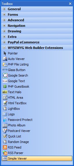

After you have restarted the software the extensions will be available in the toolbox:
Note that you do not have to load the extensions manually, they will automatically be detected by the software! If not, then please carefully read the instructions again.

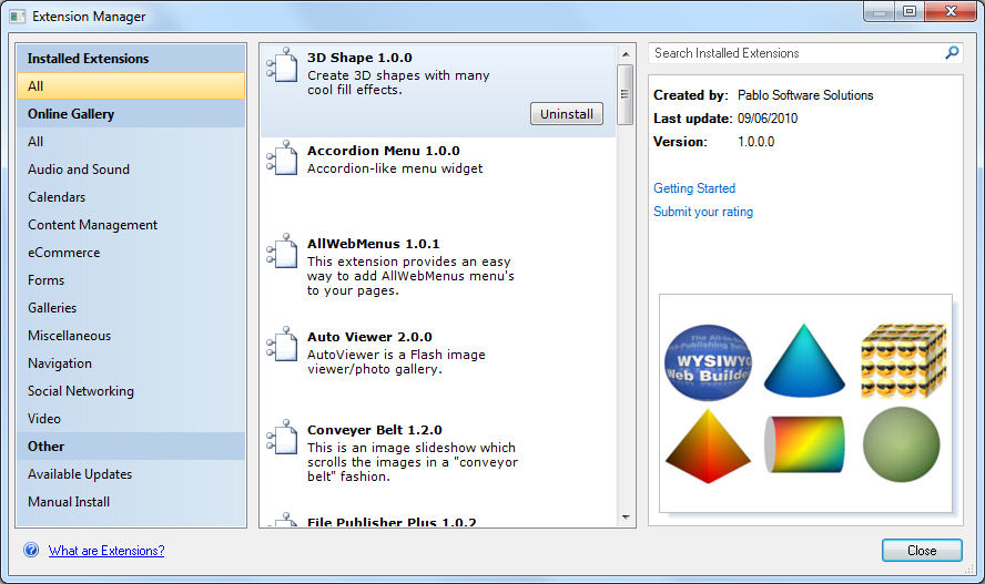

Official extensions are available here for manual download:
http://extensions.wysiwygwebbuilder.com/
But you can also use the Extension Manager.
Menu->Tools->Extension Manager

After installation the extension is not visible in the toolbox?
If you manually install extensions (by copying them to the extension folder) then you may need to reset the toolbox.
Right click the toolbox and select "Reset toolbox' or use 'Customize' to drag & drop the newly installed extensions to the toolbox.
