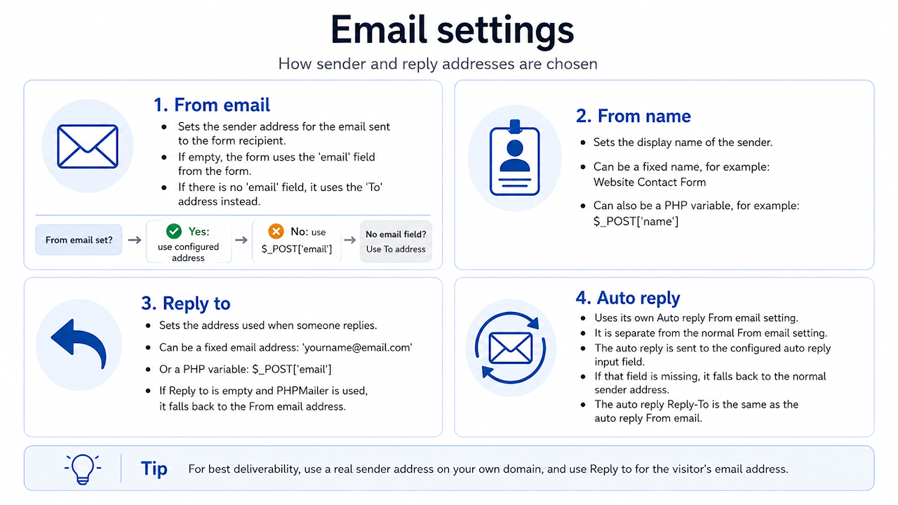

Recommended settings
In Form Properties → More Form Processor Properties, use settings similar to these:
From email:
forms@yourwebsite.com
Use a fixed email address that belongs to your website/domain.
From name:
$_POST['name']
This is optional. It uses the value of the form field named 'name' as the sender's display name. You can also enter a fixed name, such as:
Website contact form
Reply to:
$_POST['email']
This makes replies go to the email address entered by the visitor, while the message itself is still sent from your website's email address.
Why use a fixed From email?
If From email is left empty, the form processor will use the form field named 'email' as the From address when that field exists.
For example, if a visitor enters:
visitor@gmail.com
the generated message may be sent by your web server with 'visitor@gmail.com' as its From address. Some hosting providers and mail servers do not allow this.
Using a fixed address from your own domain avoids this problem:
From: forms@yourwebsite.com
Reply to: $_POST['email']
You can then click Reply in your email program and the reply will still be addressed to the visitor.
Using a fixed Reply to address
The Reply to field can also contain a fixed email address. In this field, a fixed address must be enclosed in quotes:
'yourname@email.com'
To use an email address entered in the form, use the corresponding PHP variable without quotes:
$_POST['email']
The name between the brackets must match the Name property of your email input field.

How can I make sure the 'from address' in the email message is the entered email in the form.
If the form's email input field is named 'email' then this will be used as the 'from' address for the message. Otherwise the email address configured in the form will be used as the sender of the message.
So make sure the email input field of in your form has the name 'email' (not 'e-mail' or 'Email', but 'email' !).
Note:
**From email** sets the sender email address used for the message that is sent to the form recipient.
If **From email** is left empty, the form processor will try to use the value of the form input named `email`. If the form does not contain an input named `email`, the recipient address (`To`) will be used instead.
For best delivery reliability, it is usually recommended to use an email address that belongs to the same domain as the website or SMTP account. Use **Reply to** when you want replies to go to the visitor’s email address.
**From name** sets the display name of the sender.
You can enter a fixed name, for example:
`Website Contact Form`
You can also use a PHP variable, for example:
$_POST['name']
where `name` is the name of the input field in the form.
**Reply to** sets the address that will be used when the recipient replies to the email.
This can be a fixed email address, in which case it must be entered as a quoted PHP string:
or a PHP variable, for example:
$_POST['email']
If you are using PHPMailer and **Reply to** is left empty, the form processor will use the selected **From email** address as the reply-to address.
The auto responder option does not send the message to email entered in the form.
The Input field name in the Auto Responder settings must match the Name property of the email input field in your form.
By default, the Auto Responder uses: email
This means your form must contain an input field whose Name is exactly: email
For example, these are different field names and will not match:
Email
e-mail
email_address
If your email input field uses a different name, enter that name in:
Form Properties → Advanced Form Processor Properties → Auto Responder → Input field name
For example, if the email field in your form has the name: customer_email
then set Input field name to: customer_email
Also check the From email address
The From email address is the address used to send the automatic reply. It is not the address of the visitor.
Some web hosts only allow your website to send email using an address from the same domain as the website. Therefore, it is recommended to use an address such as:
rather than:
yourname@gmail.com
The Auto Responder will then send the message from forms@yourwebsite.com to the address entered by the visitor in the form field named email.
