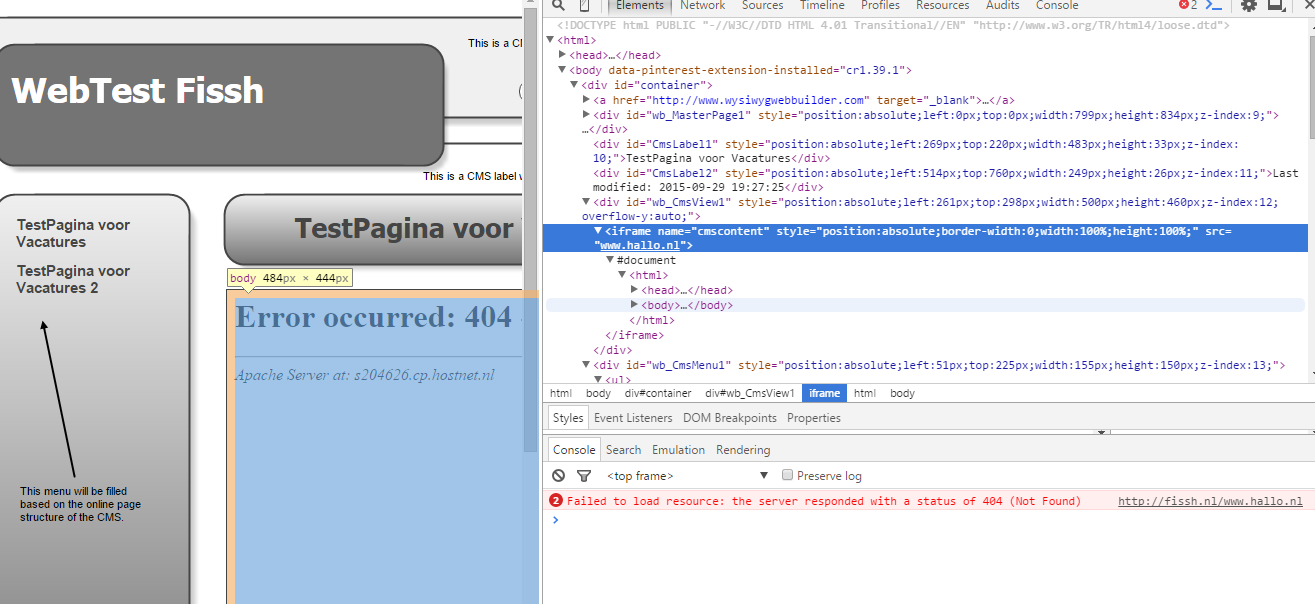

I try to setup a CMS system.
The admin parts work, but when i want to view the content i get a strange error.
Instead of reading my dbase, the viewer calls an external website "www.hallo.nl"
Am i doing something wrong ?

This probably means that you have set the 'external URL' in the CMS admin to www.hallo.nl
If you meant to use an external URL then make sure it's a valid URL (which includes http://)

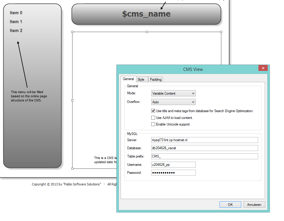

Post by Cherryman » Tue Oct 06, 2015 12:23 pm
Admin setting ( I erased the passwords )

You can edit this in the online CMS admin, where you have created the page.

Tnx it works !!
I spend all day searching for the error! In all the wrong places... But i learned a lot : )
