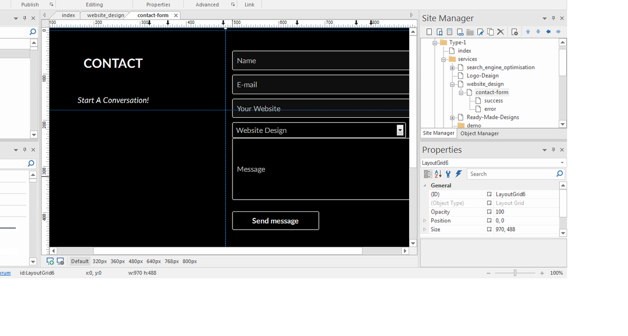

the problem is combobox is stickinjg with text area unlike editbox doing they have a distance with each other i want to do the same how do i do that?
I dont know how to reproduce it, used block contact with combobox dragged out upper part of combox has a distance with all the edit objects but only bottom part has the issue that it is sticks up with any object

Maybe the editboxes have margin at the bottom?

thanx but where do i find margins of the editbox and combobox?
yes corrrect the selection is few pixel more from box but how to edit it?
i want the margin for combobox and textarea too
evn the text area has margin at he bottom
strange thing is that instance project text area has margin and new blank page form textarea doesnot have margin
update - found the margin it was on the rightclick not iside thanx

You can find the margin settings the arrange toolbar, the context menu and in the property inspector.
By default, objects do not have a margin.
